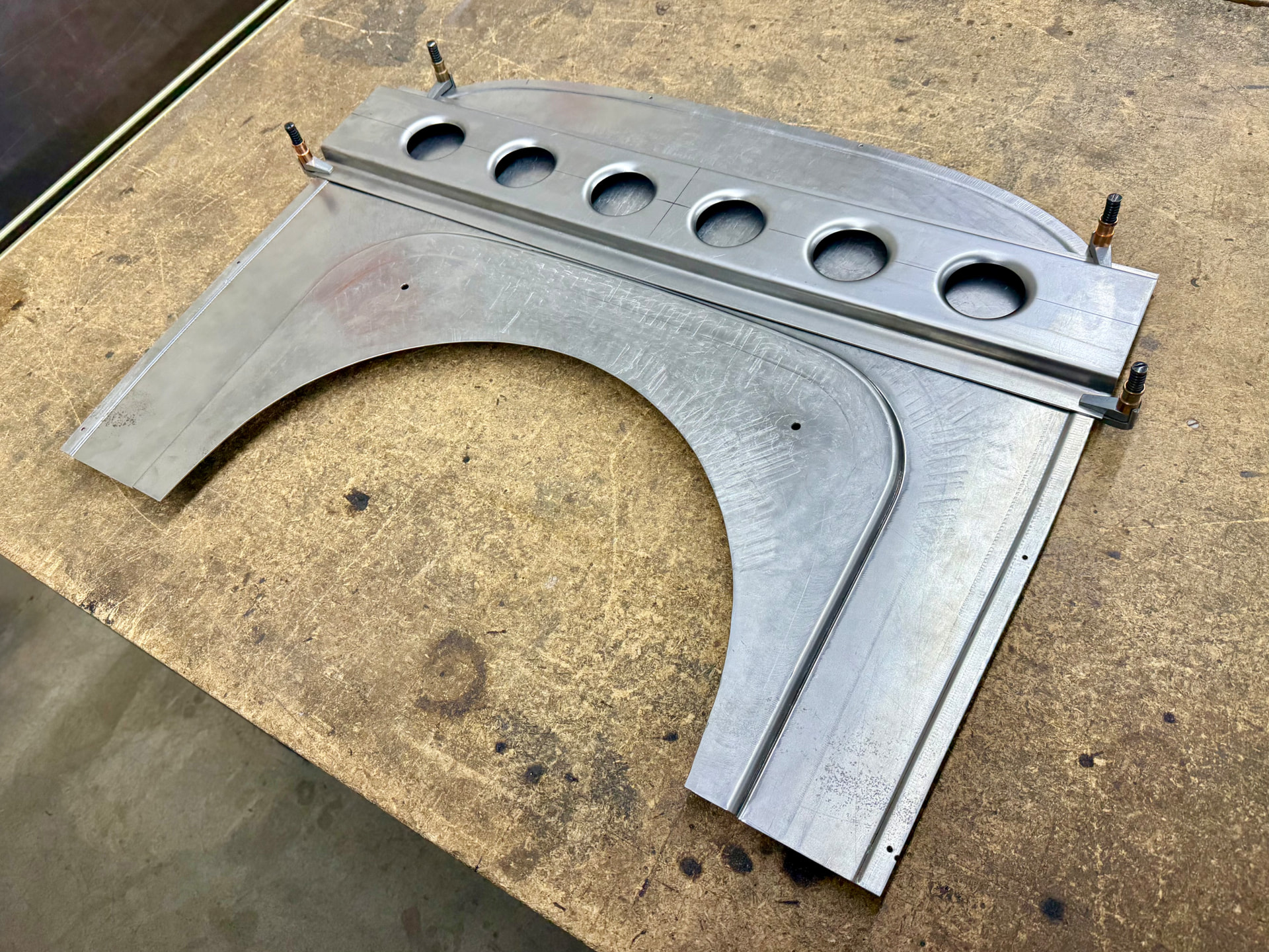

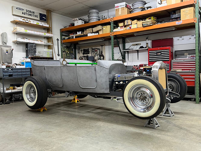

Model T Project I’m working on. Built the chassis a while back. Have started on body metal fab. Removed the original wood structure & started replacing with metal.
You do the bead work with a Pullmax?
Yes. Engine recess is 1/4" step for strength & a little clearance. Plus it looks better than just a flat panel.

Still quite a bit to do but have the lower inner door sections made.
