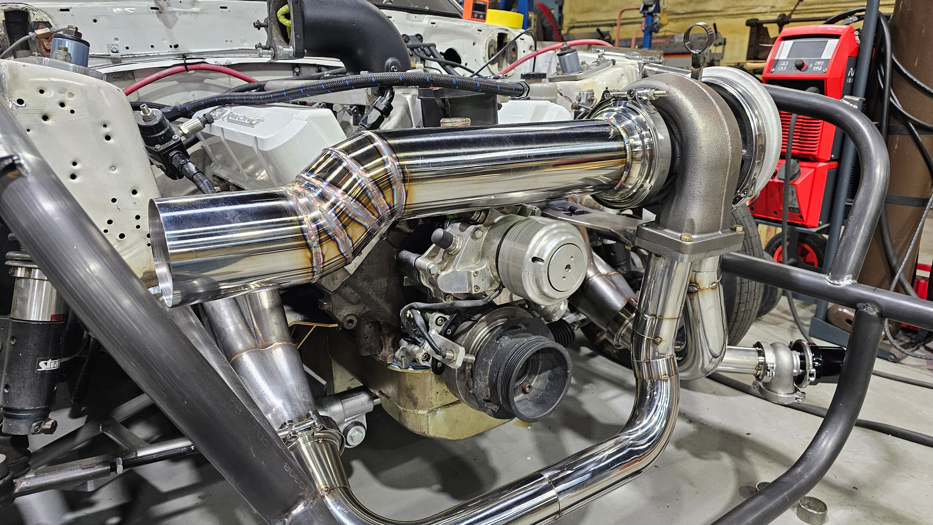

Here are a few picture I have of this build.
Turbo mounts to the cylinder head. This setup was designed to be able to pull the engine and transmission all out with the turbo setup as one piece. Remove the upper radiator support and it all slides right out the front.
