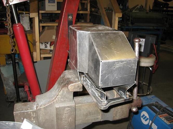

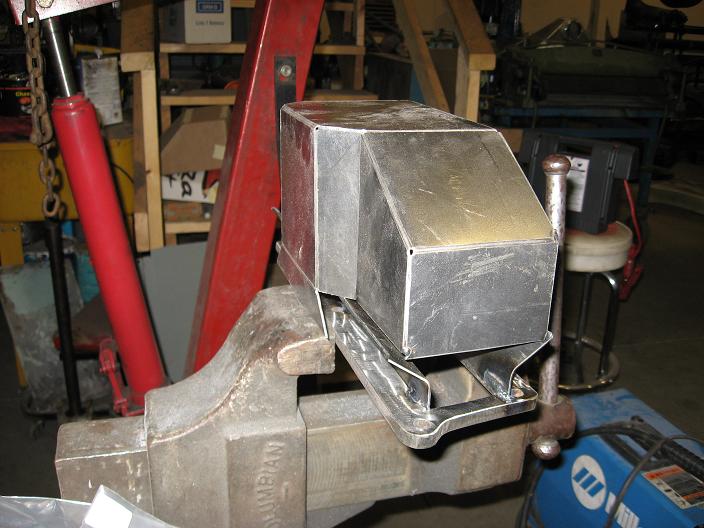

Found a lower intake off a truck 302 and built a custom sheet metal boxed upper for it.

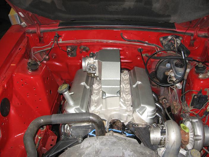

A little paint and cleaning and things were looking pretty good.

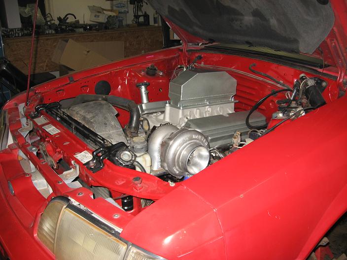

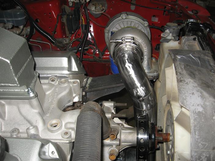

Now it was time to start building the turbo setup. I bought some shorty header and turned them around backwards, a used 70mm turbo for $400 a few tubing sets, intercooler, ebay blow off, and wastegate. I think I had $900 in all of it.
On this build I wanted to have as much of the factory look and reliability as I could, so I stuck with a belt driven water pump and fan. It made things a little tight but I was able to make it work.

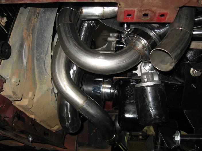

Really the downpipe was the hardest part.
