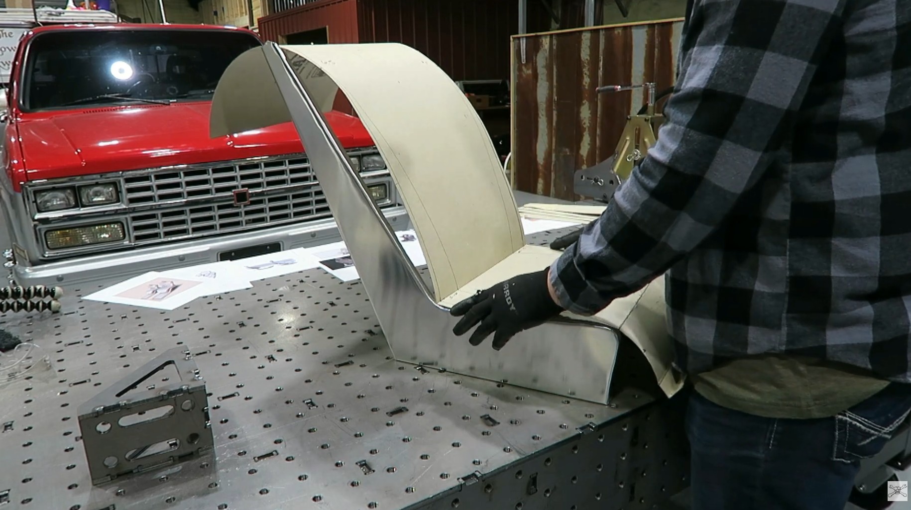

I started off making templates out of Ram board.
Found the proper lay back I needed to fit the car.

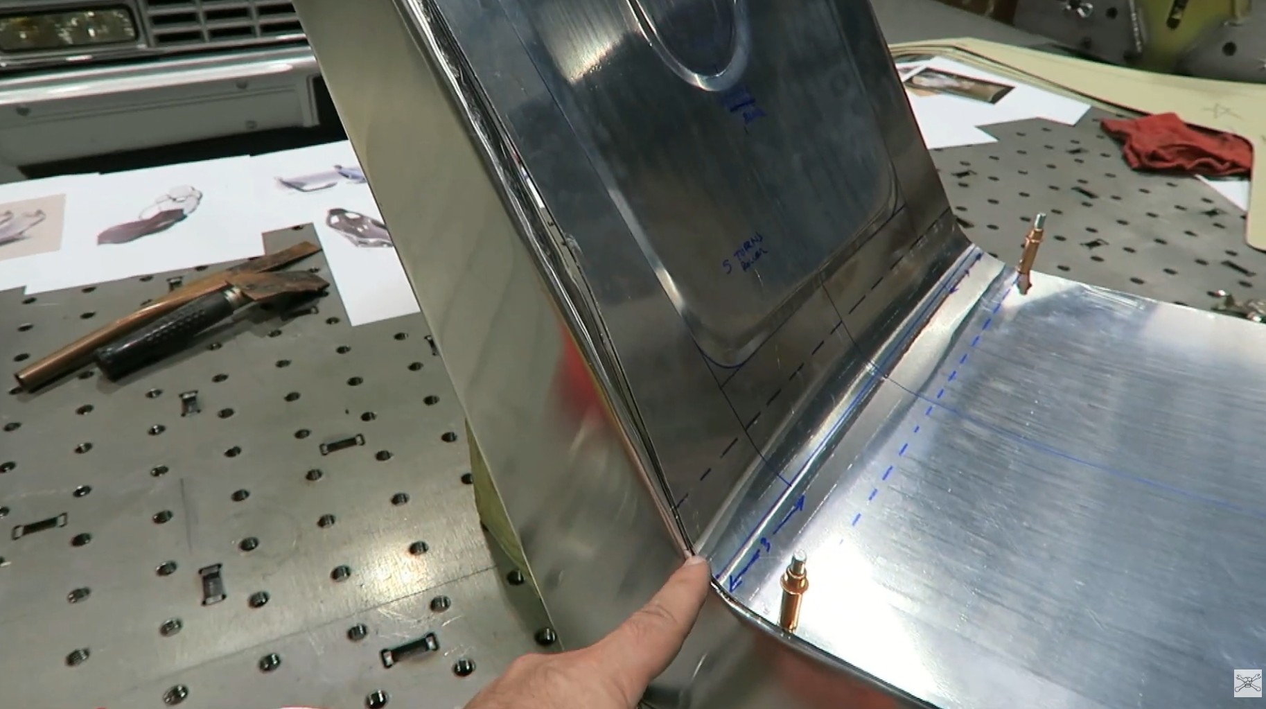

And then started cutting the aluminum. I used .050 3003 aluminum for these seats.
The side needed a flange to connect the front and bottom, so I used the bead roller to tip the edge and used the shrinker where needed.

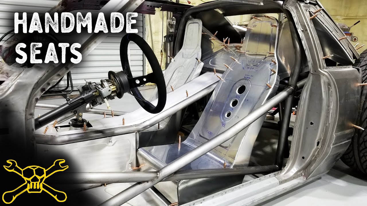

I was pretty happy with the finished product.
