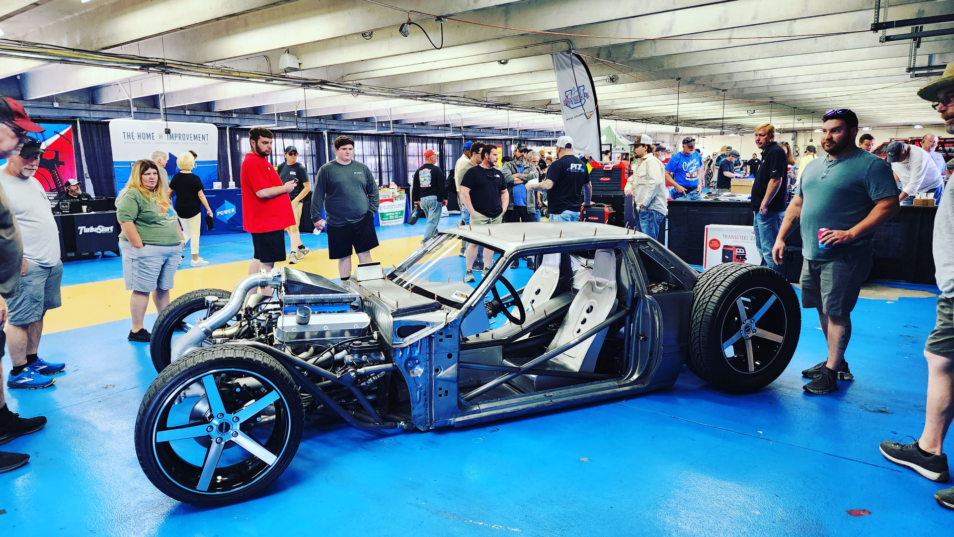

Here is my forever build. This will likely be a life long project for me. Mainly because I always come up with new ideas and vision. Here is a picture of basically where it is now.

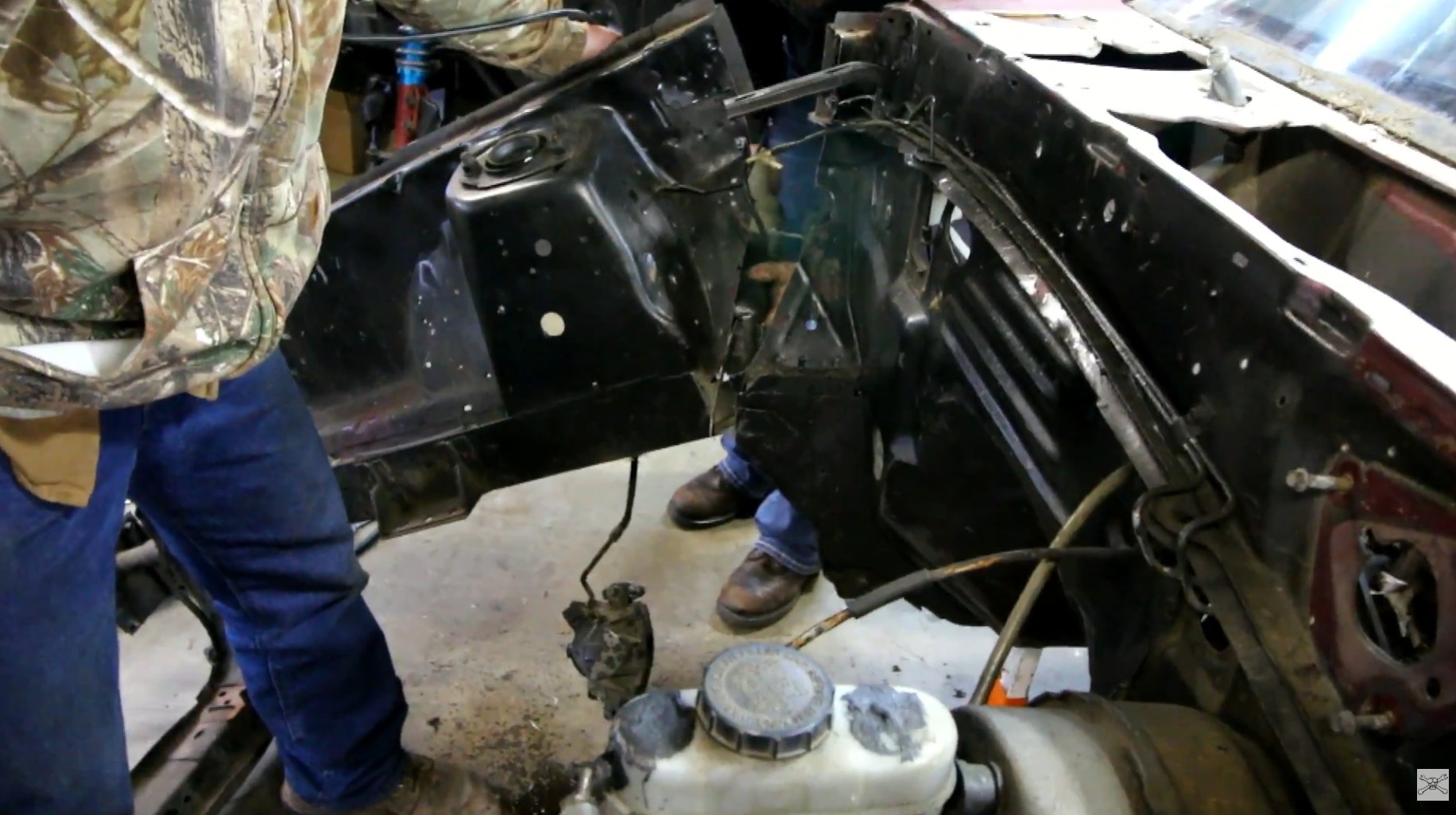

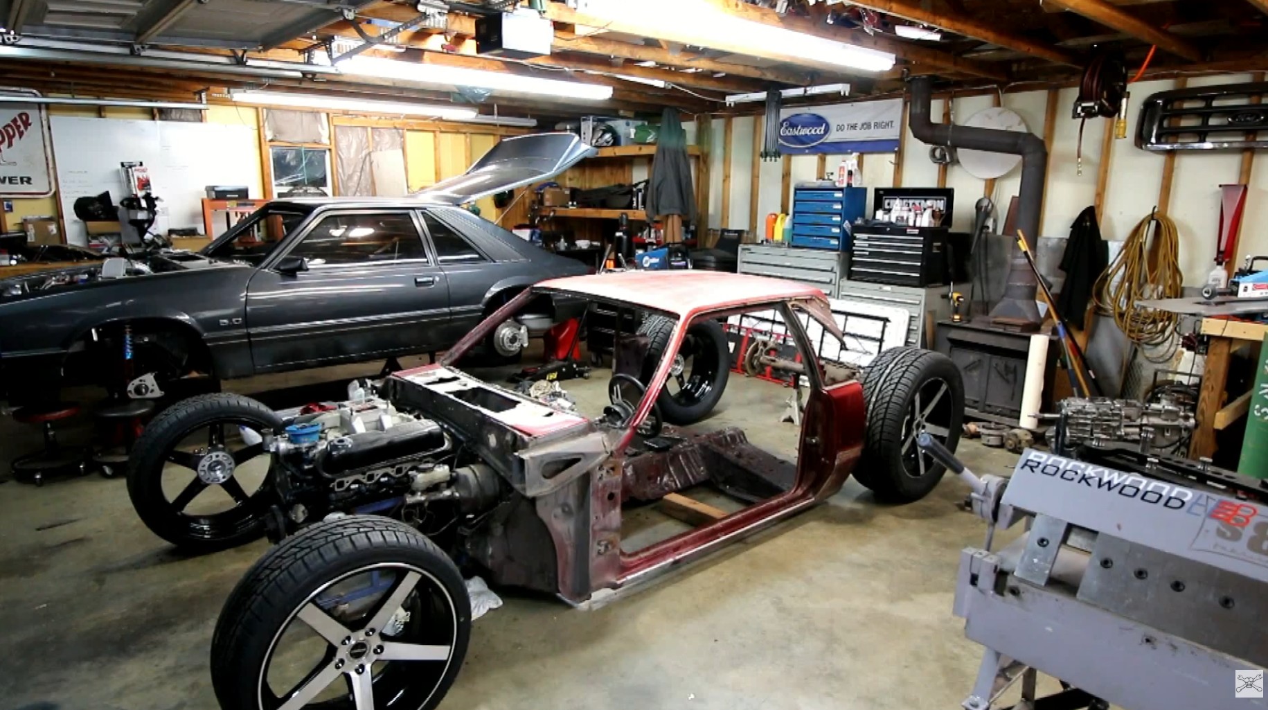

This is how it started. I bought a crappy foxbody as a doner car. Let me start by saying that this car was not worth saving regardless of how nice it might look.

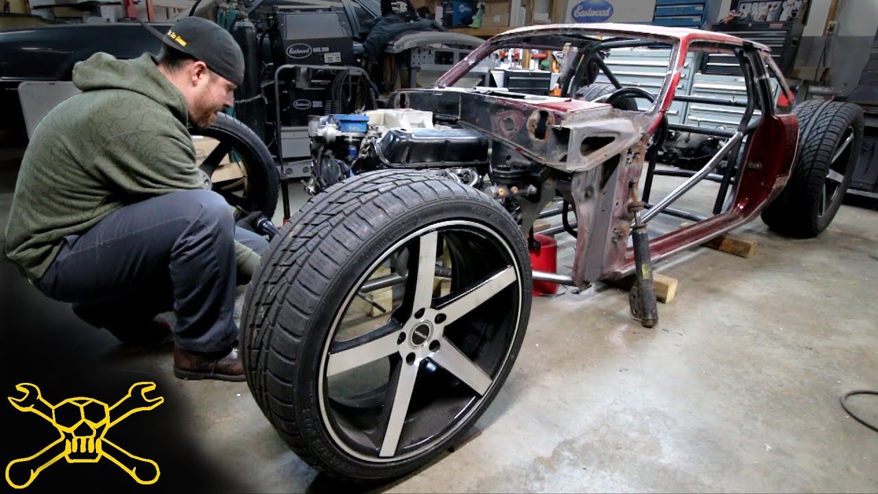

First thing I did was cut the front and back off the car.
At this point people thought I had lost my mind. (some still do)

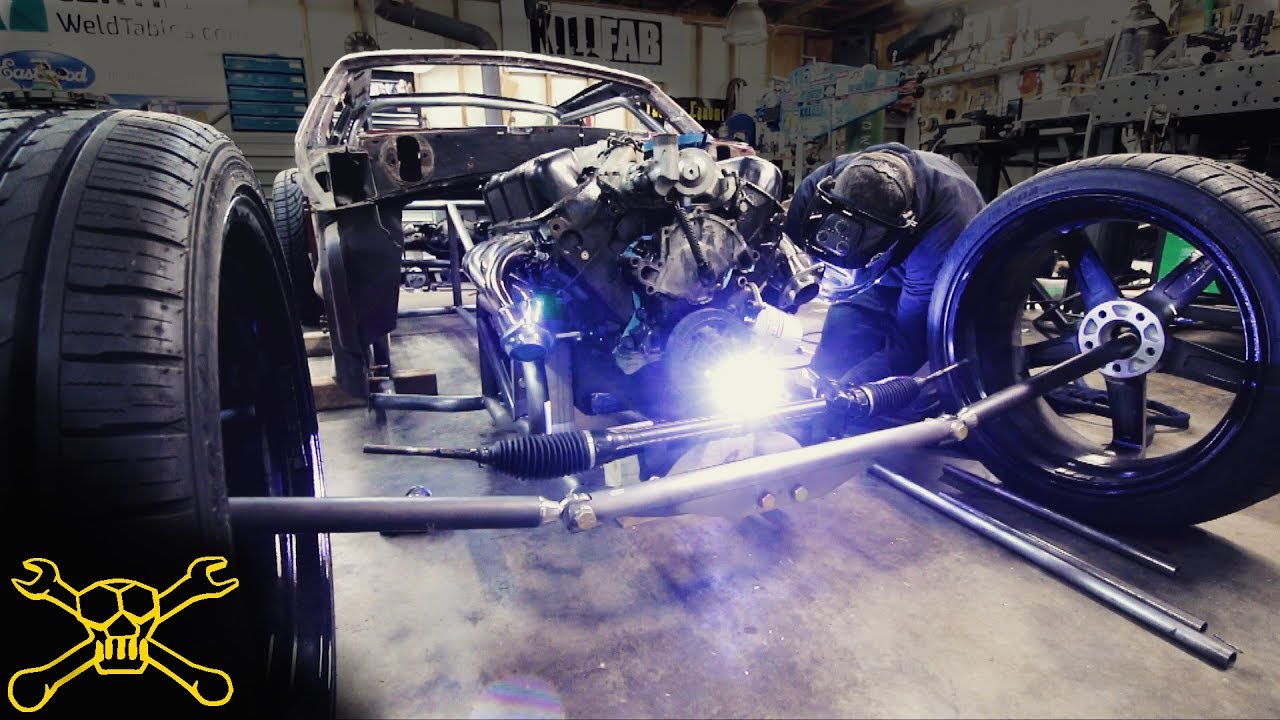

I had a vision in my head. Now was time to try and lay that vision out on the ground.
It was then time to chop the top. I took four inches off the top and eight inches out of the center. It needed to be narrower to have that hot rod look. All of this while being mindful of needing enough room to house all needed components.

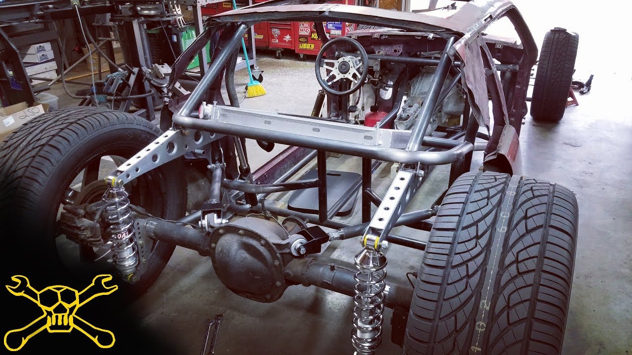

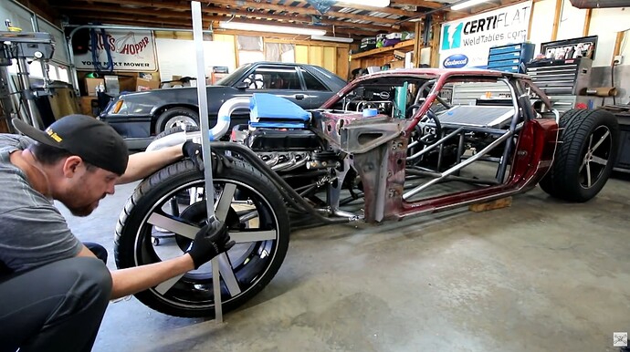

When all the measurements were taken and I felt like I have a handle on the design I started connecting the dots with the chassis.

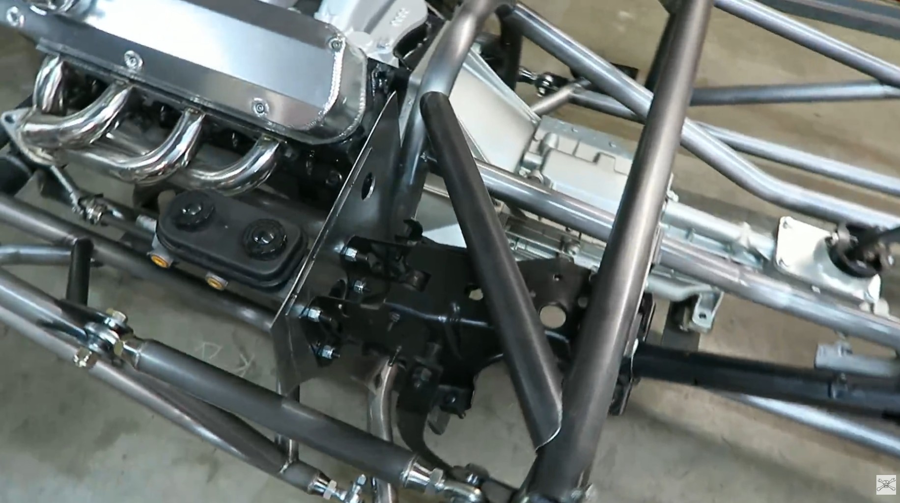

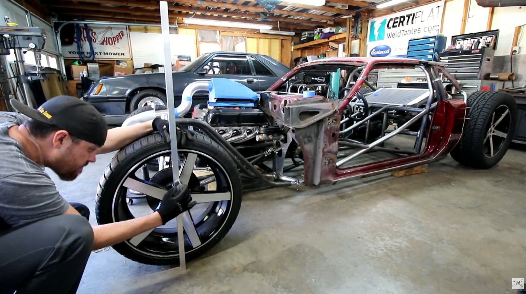

Basically just a big go kart. The entire chassis is made of chrome moly and the body can come on and off easily.
With the body on and a few panels in the interior.
