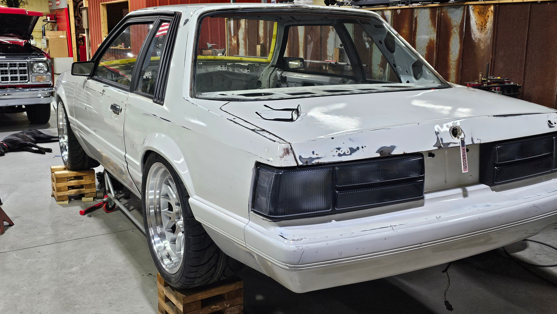

Now it was time to try and make this thing a roller. I ordered the wheels and tires I wanted and figure I would make whatever mods I needed to in order to get them to fit. 10.5x18 with 315’s in the rear and 9.5x18 with 275’s up front.
In order for these wheels and tires to work I am going to need to narrow the rear end and the front a-arms.

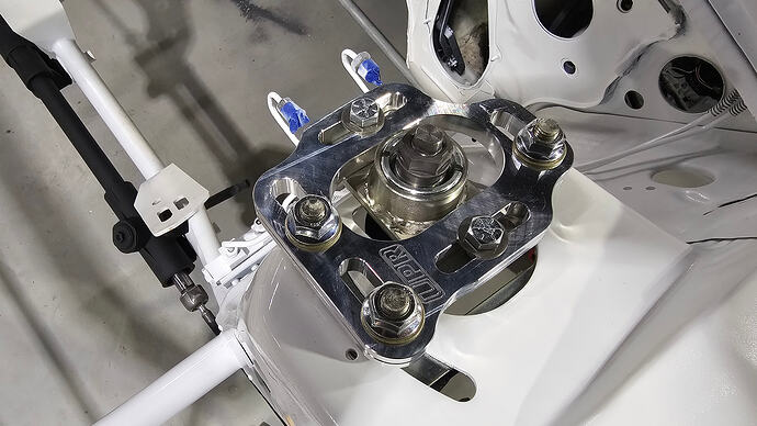

The front suspension was going to need some modifications. I went back and forth about how I wanted to tackle this. I knew I was going to need to shorten the a-arms about an inch to get the stance I wanted. The other problem was the back space on the wheel was so much that I wasn’t going to be able to run an aftermarket coil over kit. So initially I decided to make a custom spring perch that was similar to the factory one but made for the smaller coil over style spring.
Part of shortening the a-arms was going to require me to make some adjustments to the caster camber plates.

Finished the custom front suspension on the coupe. It took way more cutting and welding than I was thinking it was going to but turned out pretty nice.
