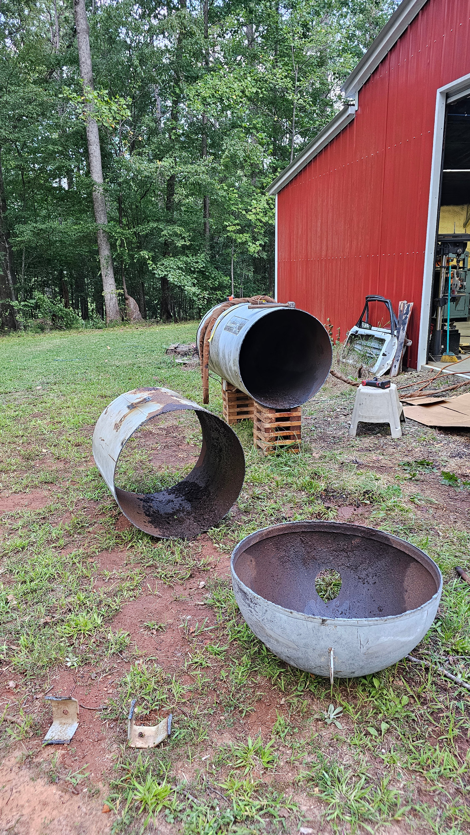

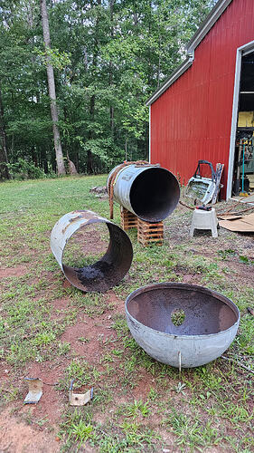

I started with a 320 gallon propane tank. With the length of these tanks I figured I would just cut out a section to be used as the fire box.
After cutting out the section I wanted to use as the fire box, I welded the end cone back on and moved everything in to the shop.
