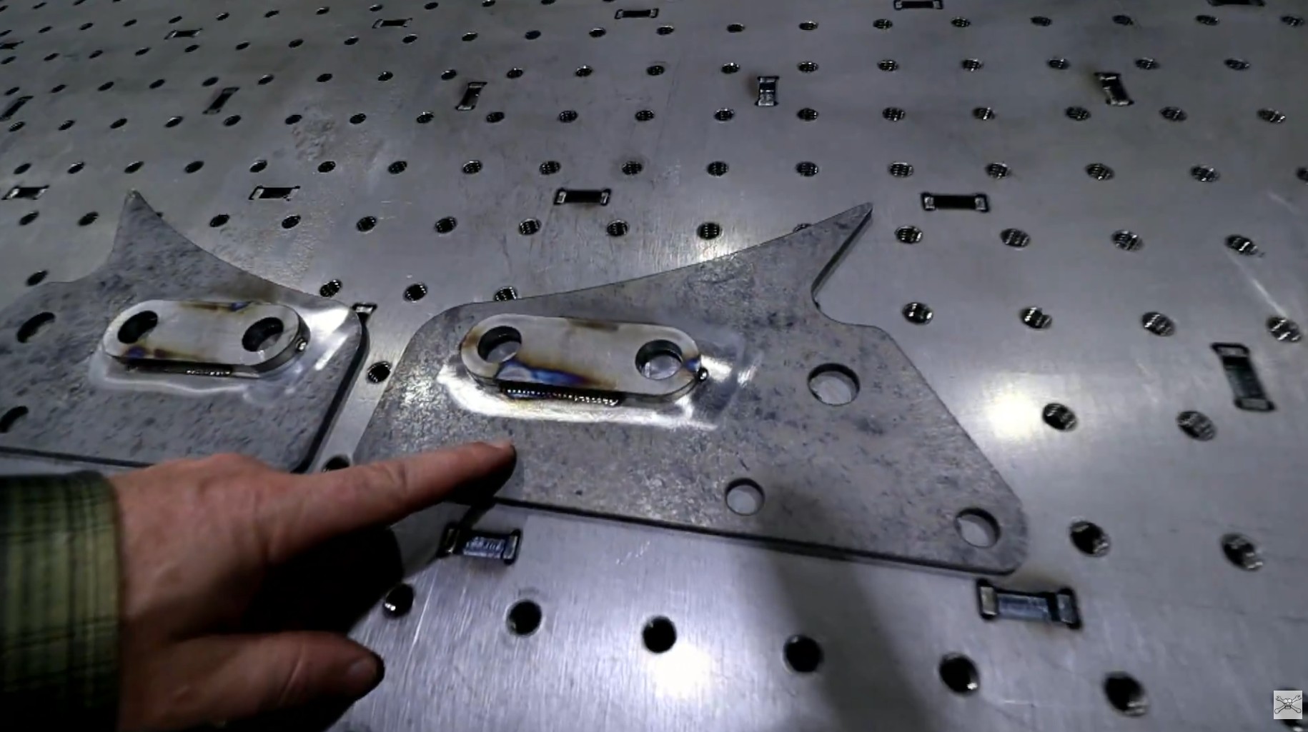

With these plates, or as I call them “wings”. It allows you to spread the wheels further apart essentially giving you more leverage on the the tube. SWAG also makes attachments that make this thing a powered roller and a hydraulic tensioner.
